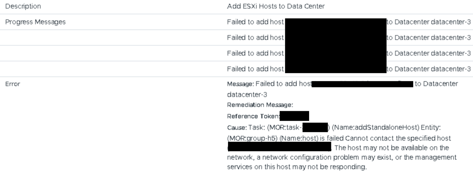

  • Attempts to add a new ESXi host to an existing cluster in VMware Cloud Foundation (VCF) via SDDC manager may fail with an error like below in the UI:
  • When reviewing the domainmanager.log entries similar to the following can be seen:
    ERROR [vcf_dm,######################] [c.v.e.s.o.model.error.ErrorFactory,dm-exec-3]  [#######] VSPHERE_ADD_HOST_TO_DATACENTER_FAILED Failed to add host <esxi_fqdn> to Datacenter datacenter-<id>
    com.vmware.evo.sddc.orchestrator.exceptions.OrchTaskException: Failed to add host <esxi_fqdn> to Datacenter datacenter-<id>
  • and/or:
    Caused by: com.vmware.vim.binding.vim.fault.NoHost: Cannot contact the specified host (<esxi_fqdn>). The host may not be available on the network, a network configuration problem may exist, or the management services on this host may not be responding.
