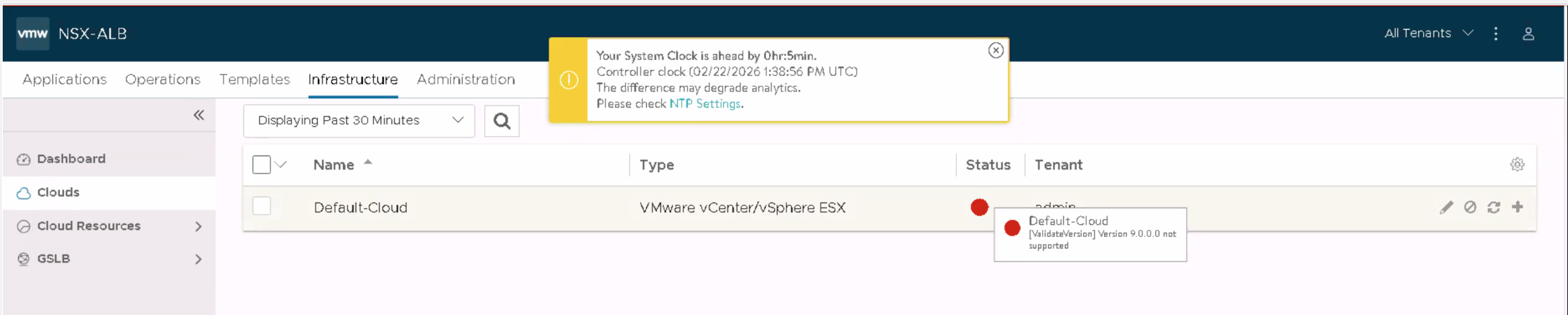

  • Upon checking the cloud status, the cloud status shows 'Red' with the error [ValidateVersion] Version 9.0.0 not supported.
  • Cloud Status shows 'Red' with the following error in the AVI controller UI.
    • "[ValidateVersion] Version 9.0.0 not supported"
