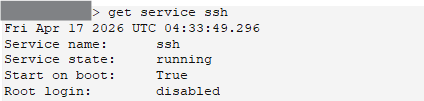

  • If root login is denied via SSH, verify that SSH root login is enabled:
    • Log in to the NSX CLI as admin.
    • Check SSH settings: get service ssh.
    • If SSH is disabled, start the service: start service ssh.
    • To allow root login specifically, ensure the /etc/ssh/sshd_config on the manager has PermitRootLogin yes  (requires console access to modify if SSH is restricted).
