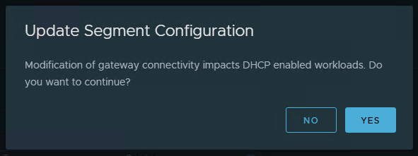

  • Below warning message would also be shown in the NSX UI when we change the Gateway connected to the Segment with Gateway DHCP configured.
