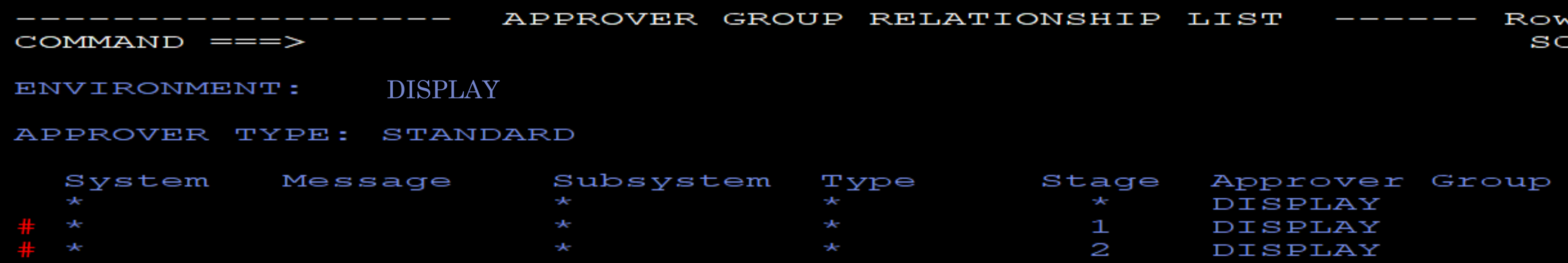

Option 1: Use the Approver Relation Screen
 (4) Environment > (A) Related Group; Spaces in the Inventory Area. Use the "#" command next to each relation you'd like to delete and step through. The commands can be stacked.
