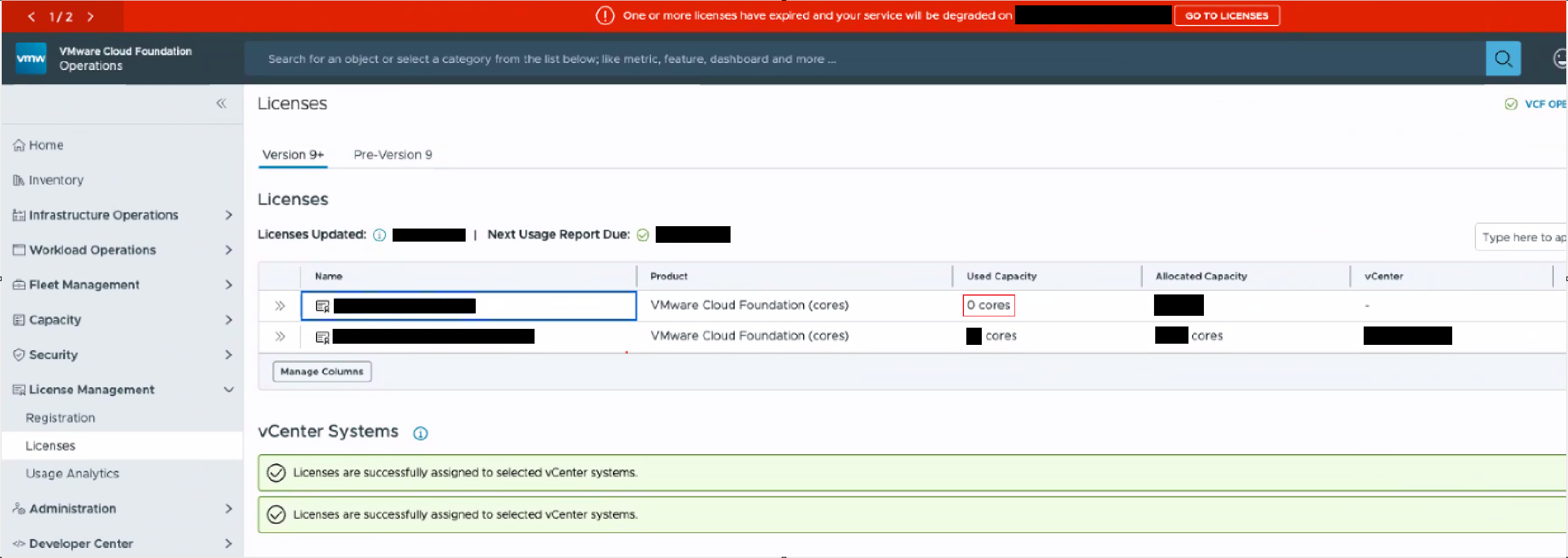

  • VCF Operations UI shows banner alert about license expiry. Further review of the license state shows 'Used Capacity' and 'Allocated Capacity" is 0 Cores, similar to below screenshot

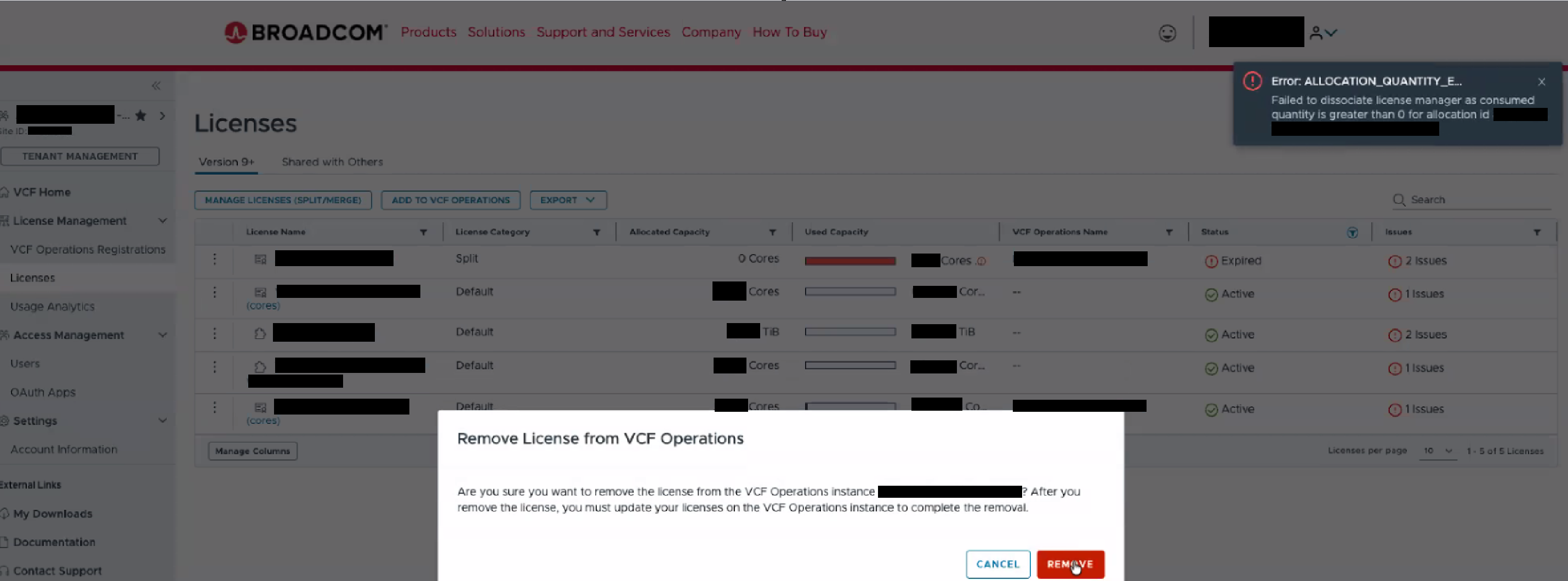

  • When you attempt to remove the license by clicking on VCF Operations > Licenses > Select 'example.license.name > Click on Vertical Ellipses (Three dots) > Remove, you will encounter an error that reads, "ALLOCATION_QUANTITY_E' Failed to dissociate license manager as consumed quantity is greater than 0 for allocation id......"

  • From the above referenced screenshot, the error message makes it clear that the license is expired and is a stale entry present in VCF Operations.

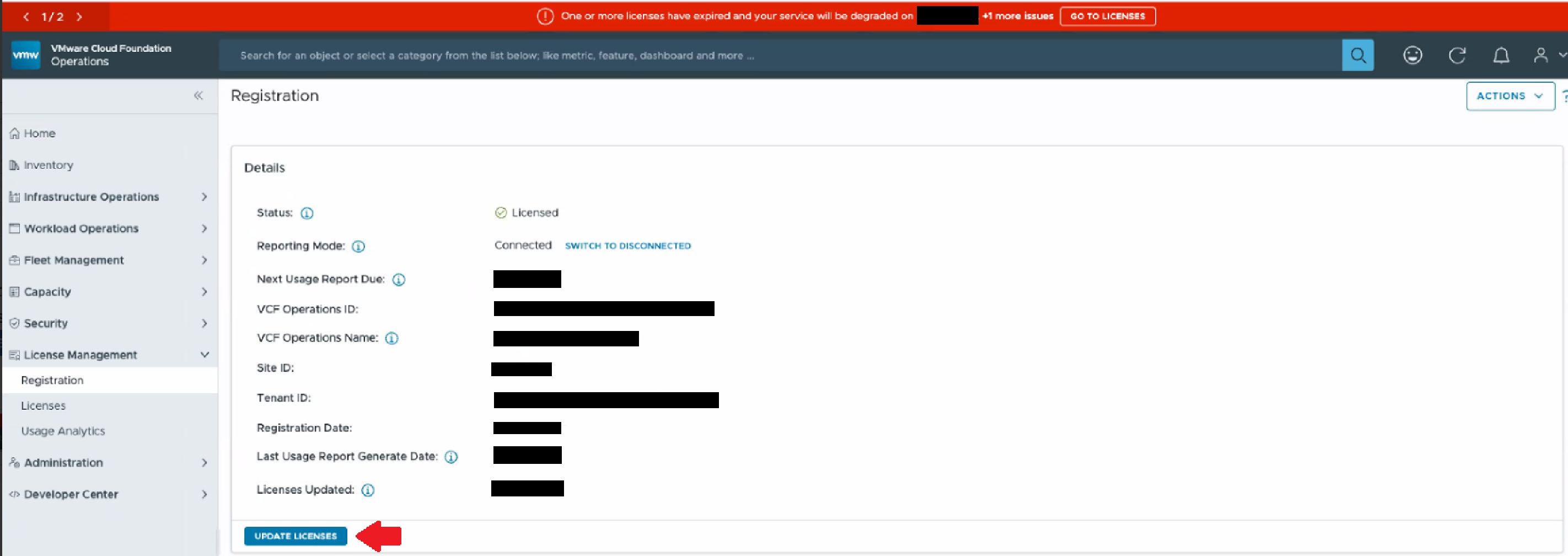

  • Initiate sync in VCF Operations UI, by navigating to VCF Operations > License Management > Registration and click on Update License, as shown below
