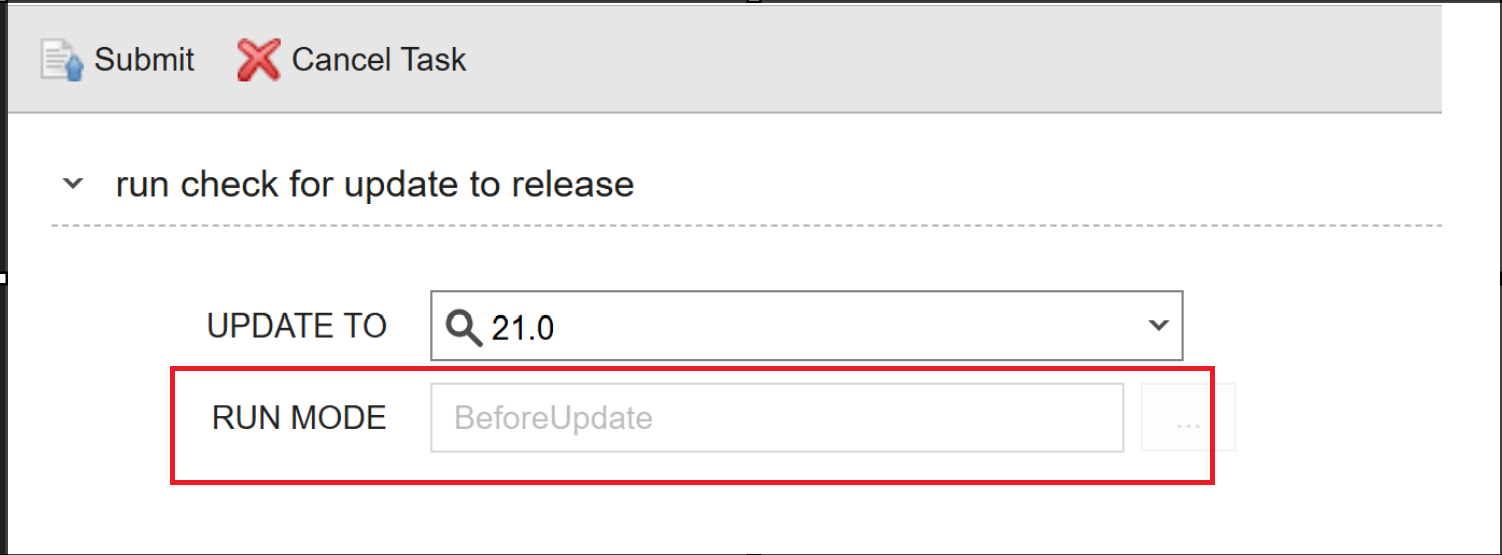

Upgrade Checker Action pack defaults to RUNMODE "BeforeUpdate" and  the option to choose "AfterUpdate" is not available while using the Action Pack.

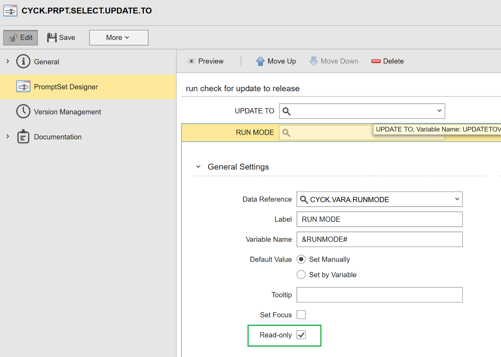

The "AfterUpdate" mode can be enabled by the following steps:
Edit the CYCK.PRPT.SELECT.UPDATE.TO Promptset (as you would see that the RUNMODE is set to read-only)
Simply uncheck the read-only checkbox and save the Promptest and you should be able to select Afterupdate within the RUNMODE upon executing the Action Pack.
