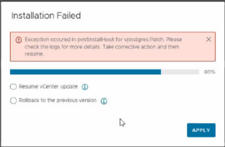

vCenter update stuck and failed at 80% with an Error "Exception occured in postinstallHook for vpostgres:Patch"

  • When attempting to patch or update the vCenter Server Appliance (vCSA) , the upgrade process fails and stuck at 80% with an Error: "Exception occurred in postinstallHook for vpostgres:Patch"
  • vCenter services vmware-vpxd and vmware-vpxd-svcs failing to start after patch failure."
  • For example, the update fails when updating the vCenter server from 8.0.3 (24853646) to 8.0.3 (25092719)
