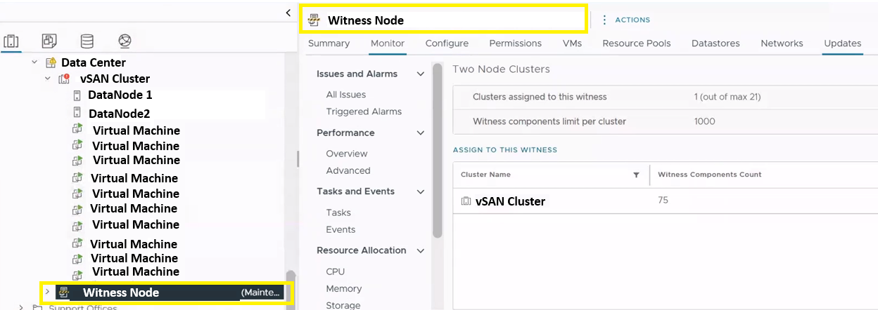

  • The VM snapshot and backup failures occurred because the vSAN witness node was in maintenance mode.

  • In this state, the disks on the witness appliance cannot accept new writes, which causes witness component creation to fail. Consequently, the system is prevented from creating any new vSAN objects, such as those required for snapshots.
  • All objects in the vSAN cluster are in the reduced availability with no rebuild state as the witness node is in maintenance mode.
  • Provisioning new vSAN objects, such as those required during snapshot creation, is not possible in the current cluster state. The applied vSAN RAID 1 storage policy dictates that the 2-Node cluster must have both data nodes and the witness available to fulfill the placement requirements for any new objects.
  • As a result, backups fail because it is not possible to create the required snapshots.
Exit maintenance mode on the vSAN witness node.
