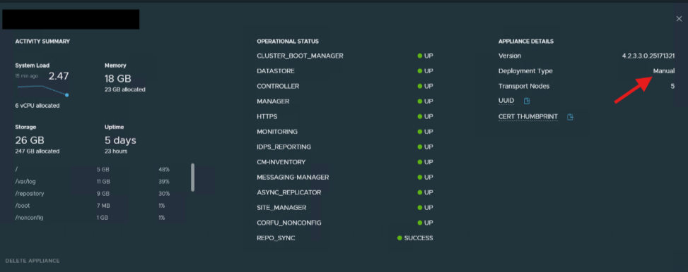

To confirm whether the manager cluster was deployed via the NSX UI or manually, perform the following validation steps in your NSX environment:
  1. Log in to the NSX Manager User Interface (UI) using your administrator credentials.
  2. From the main navigation menu, go to System > Appliances.
  3. Locate your deployed NSX Manager nodes on this screen. For each appliance you want to check, click on the View Details link.
  4. Review the information in the Appliance Details column/pane.

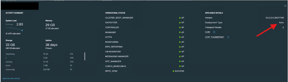

  5. Look specifically for the Deployment Type field to determine your next steps:
    • Auto: This indicates the nodes were deployed directly via the NSX UI.
    • Manual: This indicates the nodes were deployed manually using the CLI or vCenter OVF template.
