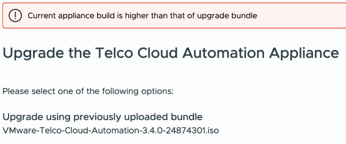

  • Error:
    Current appliance build is higher than that of upgrade bundle
  • TCA upgrade fails due to incorrect version validation
TCA: 3.3.0.1, 3.4
TCP: 5.0.2, 5.1
  • When upgrading TCA from 3.3.0.1 to 3.4.0, the upgrade validation incorrectly treats the source version (3.3.0.1) as a higher number than the target version (3.4.0),  preventing the installation of RPM packages and causing the upgrade to fail.
Workaround
  1. Go to the file /etc/vmware/cap/product.info and change the build_number to lesser than 3.4.0
  2. In /opt/vmware/config/cnva_version.properties, change the build number to lesser number than 3.4.0
