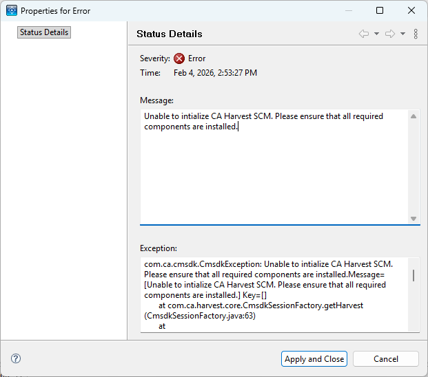

If the installation is not completed correctly, you may find the process finishes and appears to succeed, but when opening the Administrator Tool and trying to create a broker connection an error message is returned:
com.ca.cmsdk.CmsdkException: Unable to intialize CA Harvest SCM. Please ensure that all required components are installed.Message=[Unable to intialize CA Harvest SCM. Please ensure that all required components are installed.] Key=[]
   at com.ca.harvest.core.CmsdkSessionFactory.getHarvest(CmsdkSessionFactory.java:63)
   at com.ca.harvest.ui.wizards.BrokerLoginPage.useOSAuthentication(BrokerLoginPage.java:225)
