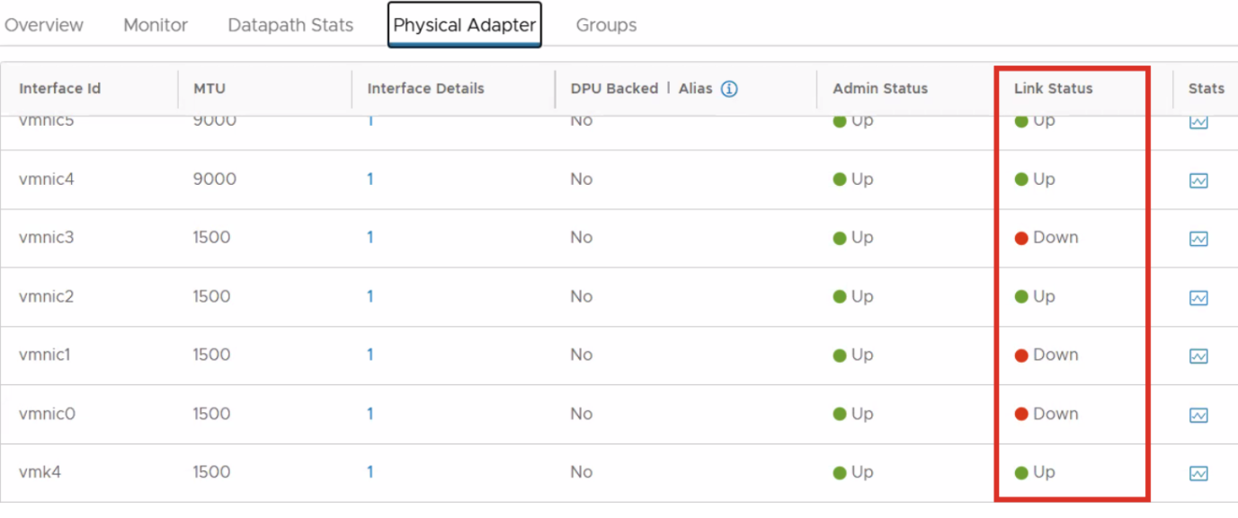

  • In vCenter, when viewing the ESXi host, under Configure, Virtual Switches, under Physical adapters, the vmnics Link Status show as Down, but the Admin status show as Up.
  • Cable is properly connected to the interfaces and the switchport is active on the physical switch.
  • Issue is the same after physically removing and reseating the network interface.

  1. Verify Command-Line Status Connect to the ESXi host via SSH as user root and run the following command to check the exact Link and Admin status:
    esxcli network nic list
    If Link Status is Down but Admin Status is Up, the issue is physical or driver-related rather than an ESXi configuration setting.
