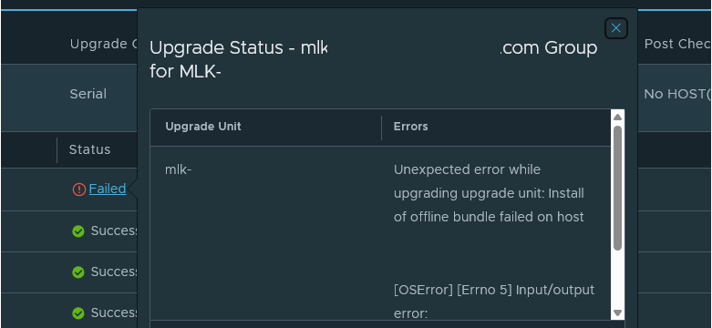

Unable to complete NSX upgrade due to error:
Unexpected error while upgrading upgrade unit: Install of offline bundle failed on host XXXXXXXX-XXXX-XXXX-XXXX-XXXXXXXX with error : [OSError] [Errno 5] Input/output error: '/var/vmware/lifecycle/hostSeed' Please refer to the log file for more details..

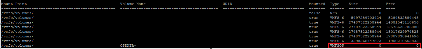

Host is unable to read it's boot media:
Could not open /bootbank
Error: No such file or directory
OBJLIB-LIB: ObjLib cleanup done.
WORKER: asyncOps=0 maxActiveOps=0 maxPending=0 maxCompleted=0
Looking at the datastores on the host it shows that the size and usage of the OS datastore are both 0
Reboot host to restore connectivity to the boot device.  If the host reboot does not clear the issue contact hardware vendor to further troubleshoot the boot device.
