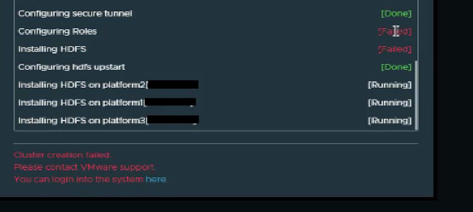

Exception("Failed executing command errcode[%d] command:%s" % (code, cmd_log))Exception: Failed executing command errcode[1536] command:sudo ssh -q -i /home/support/.ssh/id_rsa_vnera_cluster_keypair -o StrictHostKeyChecking=no -o UserKnownHostsFile=/dev/null support@##.###.##.## "sudo -S su ubuntu -c 'hdfs zkfc -formatZK -force'"2026-02-11T21:32:03.718Z INFO
Aria Operations for Networks 6.13.0
Aria Operations for Networks 6.14.X
Communication between Platform node 1 and the 2 new Platform nodes is not allowed thru NSX DFW rule so Platform node1 cannot reach nodes 2 and 3 for Clustering.
To test the communication from Platform 1 to Platform 2 and 3 you can run the following commands as the Support user and you should have a SUCCESSFUL connection
#ub
#nc -vz platform# 2181
Example
ubuntu@platform1:~$ nc -vz platform2 2181Connection to platform2 (###.###.##.##) 2181 port [tcp/*] succeeded!ubuntu@platform1:~$ nc -vz platform3 2181Connection to platform3 (##.###.##.##) 2181 port [tcp/*] succeeded!
Allow communication between all Platform nodes thru NSX DFW.
Once communication has been enabled re-run above commands to verify connection and restart clustering process.
