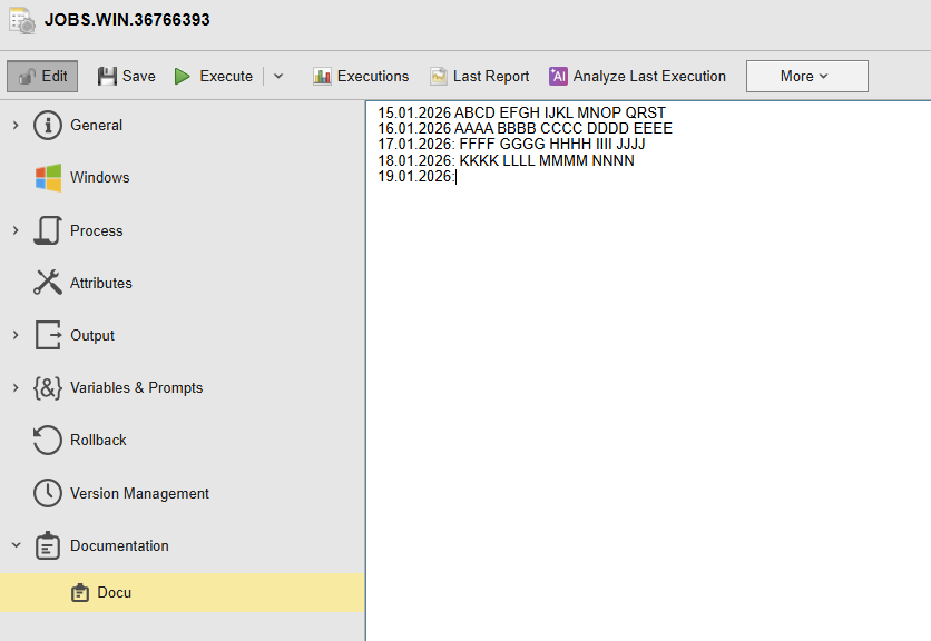

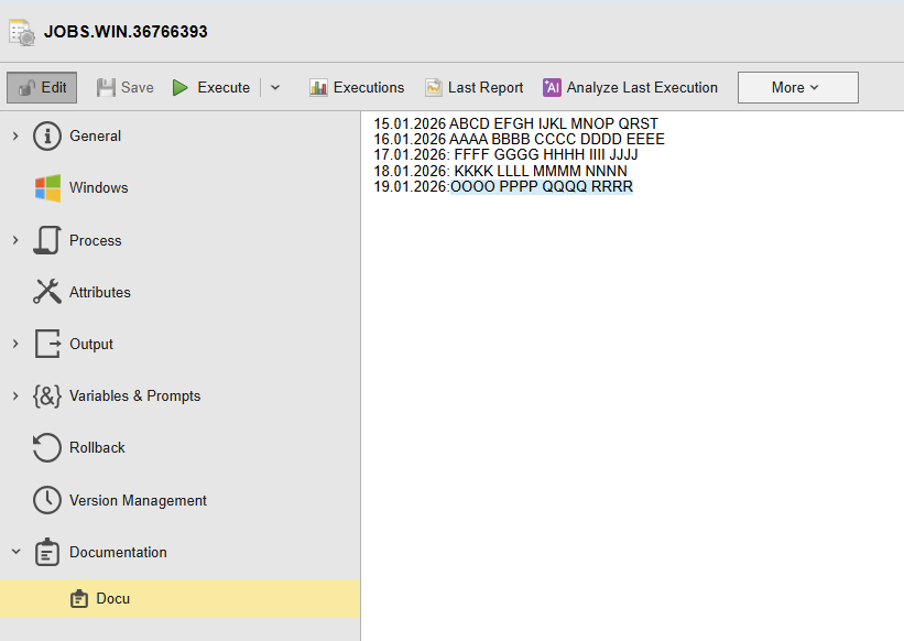

When a user opens an object and switches to the Documentation panel, highlighting a portion of an existing text entry with the mouse causes the text to be automatically deleted immediately upon releasing the mouse button.
This unexpected behavior is reproducible at will on the Documentation pane.
The issue also intermittently occurs in other editor frames, such as the Process, Pre Process, and Post Process tabs.
The problem is most prominent when text selection is the very first action taken with the mouse within the frame.
