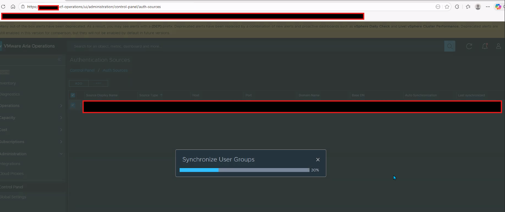

  • This issue is caused due to AD not syncing at the Aria Operations UI Auth Sources tab
  • Also the Last Modified date will not update, even after successful syncing in the Auth Sources tab

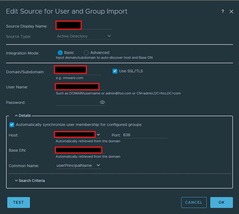

Following actions needs to perform to fix this issue -
  • Test the connection with the existing details as shown in the Edit Source for User and Group Import form inside Authentication Sources Tab
    (Administration > Control Panel > Auth Sources)
  • Check and update AD settings and make sure the User Name and Password are intact
  • Check the Details and change host details from Automatic to desired hostname, if Automatic option is not testing the AD connectivity successfully as shown below-
