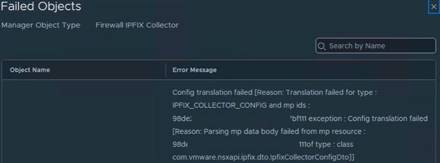

    Found data inconsistencies: MP Objects found in DB before promotion for tables : IpfixCollectorConfig. please perform Manager to Policy promotion or delete the MP objects and retry the prechecks. Delete any Bridge firewall section/rule if they exist, and then retry the prechecks. For more details, please refer to - https://knowledge.broadcom.com/external/article/385606
  • When you try to "start object promotion" from the NSX manager under the System--> General settings --> Manager objects promotion, you see the following error:
  • Copy the UUID from the error and search for it in the NSX Manager to verify the configuration.
  • After that, log in to vRNI and confirm that the settings align with the current configuration.
