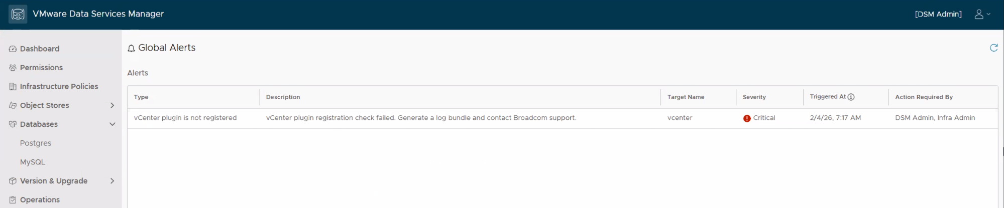

You see the following alarm from DSM
In  /var/log/tdm/provider/containers/dsm-tsql-provisioner-service.log You see an alarm similar to the following.
{"level":"error","timestamp":"2026-02-18T14:35:31.910Z","C":"vcenterbinding/vcenterbinding_controller.go:229","message":"registerVCPluginIfNotRegistered","controller":"vcenterbinding","controllerGroup":"system.dataservices.vmware.com","controllerKind":"VCenterBinding","VCenterBinding":{"name":"vcenter"},"namespace":"","name":"vcenter","reconcileID":"8ba3c9c9-50ee-493d-8c08-############","objName":"vcenter","objType":"############.VCenterBinding","Status":"error checking plugin registration: error fetching plugin server host: failed to connect to SSH server: ssh: handshake failed: ssh: unable to authenticate, attempted methods [none publickey], no supported methods remain","error":"error checking plugin registration: error fetching plugin server host: failed to connect to SSH server: ssh: handshake failed: ssh: unable to authenticate, attempted methods [none publickey], no supported methods remain","S":
