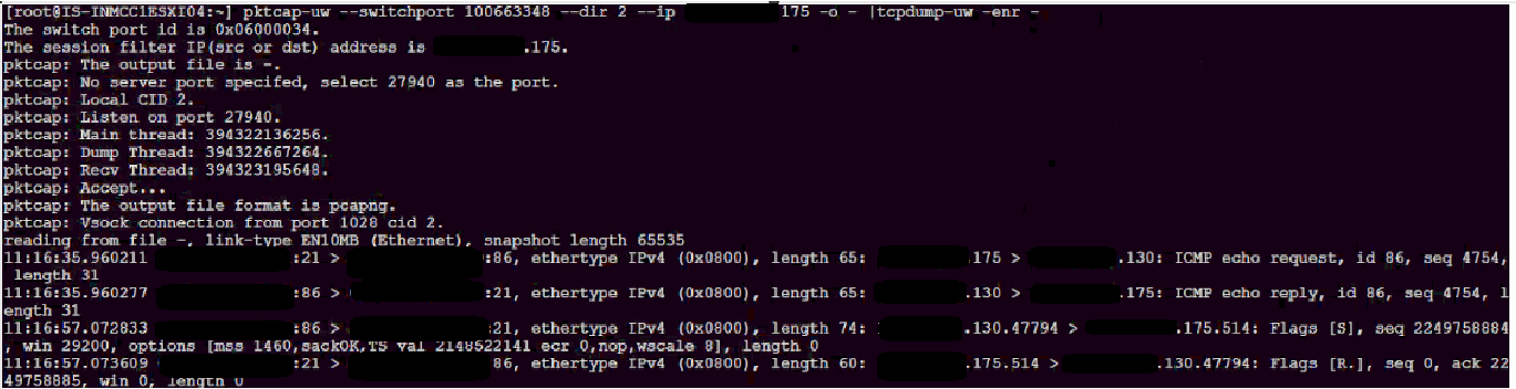

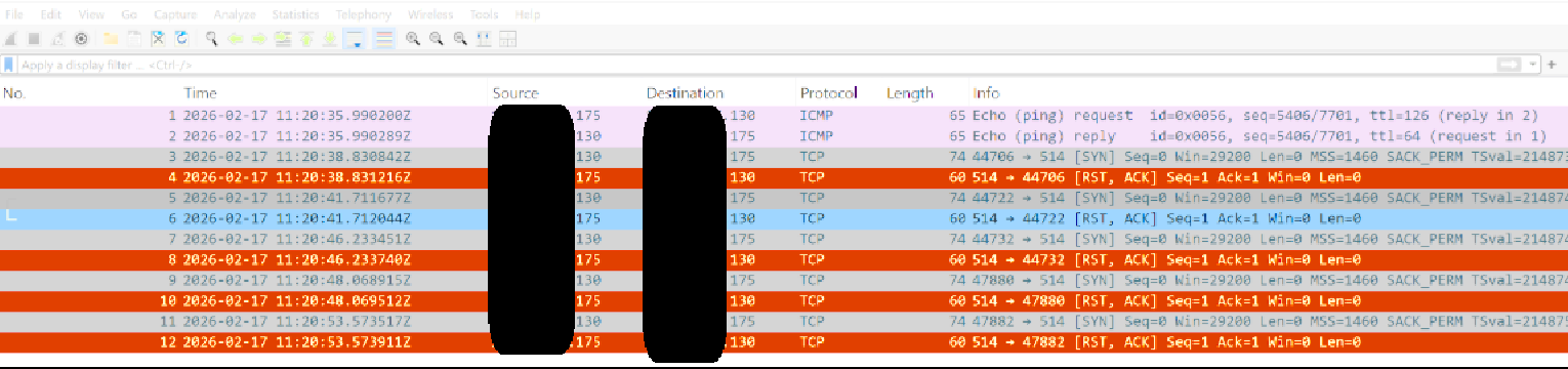

  •  From packet capture we determined that the packet was leaving the vCenter VM and we are seeing some reply from the syslog server, however when we captured the files to a file and opened the same in Wireshark the output was as follows
  •  From the  packet capture the reply packet coming back from the Syslog server was RST packet and not the syn-ack packet which indicates port block of the port 514 for TCP traffic.
