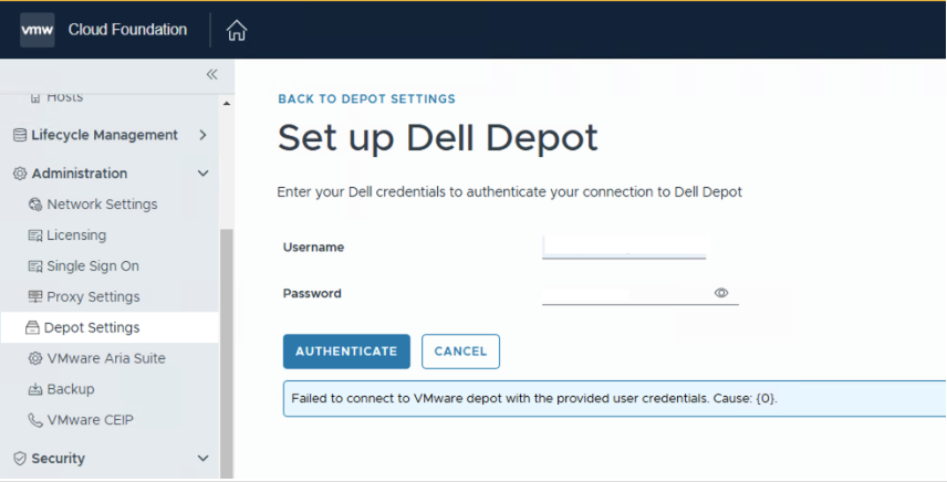

When attempting to configure or sync the Online Dell Depot in VMware Cloud Foundation (VCF) via SDDC Manager, the connection fails. The SDDC UI displays error: "Failed to connect to VMware depot with the provided user credentials. Cause: {0}."
