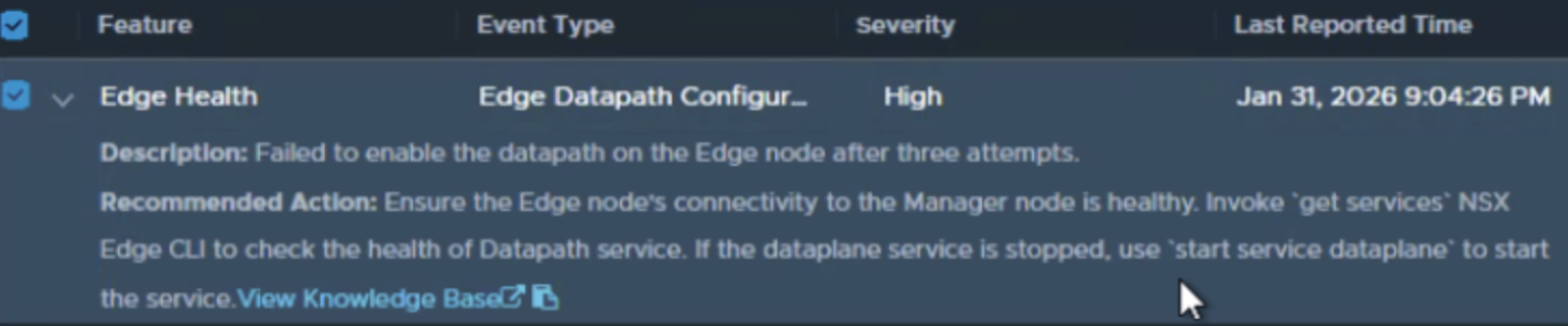

  • Edge tunnel went down or it stuck at not available state, tier1 gateways were in down state.
  • North-south and east-west traffic will be impacted.
NSX Manager var/log/syslog
2026-02-01T02:28:07.548Z  NSX 5020 MONITORING [nsx@6876 alarmId="ID" alarmState="OPEN" comp="nsx-manager" entId="ID" errorCode="MP701099" eventFeatureName="edge_health" eventSev="HIGH" eventState="On" eventType="edge_datapath_configuration_failure" level="ERROR" nodeId="ID" subcomp="monitoring"] Failed to enable the datapath on the Edge node after three attempts.
var/log/syslog:2026-02-01T02:28:21.546Z  NSX 5020 MONITORING [nsx@6876 alarmId="ID" alarmState="OPEN" comp="nsx-manager" entId="ID" errorCode="MP701099" eventFeatureName="edge_health" eventSev="HIGH" eventState="On" eventType="edge_datapath_configuration_failure" level="ERROR" nodeId="ID" subcomp="monitoring"] Failed to enable the datapath on the Edge node after three attempts.
