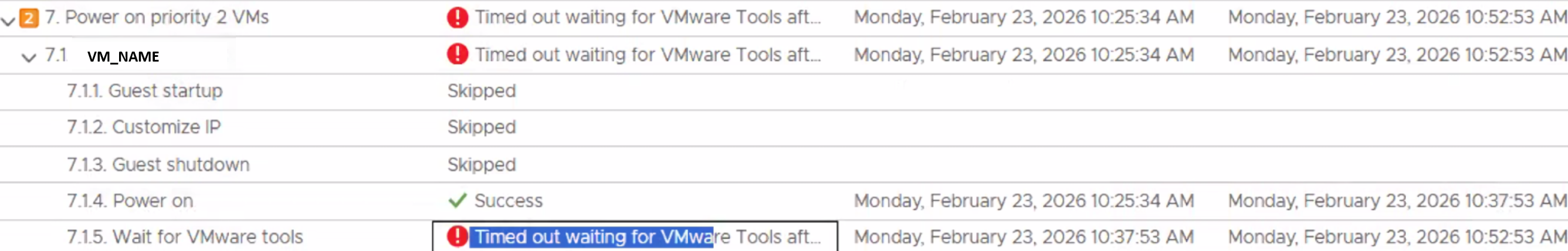

During a VMware Site Recovery Manager (SRM) Test Recovery or "Bubble Test" (isolated network test), virtual machines successfully execute the "Power On" step but fail shortly after. The recovery plan terminates with a timeout error, preventing the VM from running at the recovery site.
  • SRM Task: "Power On VMs" (or similar) fails.
  • Error Message: Timed out waiting for VMware tools after [300 or 900] seconds.
  • Log Context: vmware-dr.log displays: Wait for VM Tools in VM failed: (dr.recovery.fault.ToolsTimedout).
  • Bubble Test Context: If the error occurs at 300 seconds, it typically indicates a delay in VMware Tools initialization during isolated network tests, often before the longer 900-second watchdog timer is reached.
