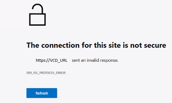

  • VCD(VMware Cloud Director) is successfully upgraded from 10.4.x to 10.5.1 or above(including 10.6.1.2) and cell startup is succesfully completed on all the cells.
  • Accessing the VCD provider portal fails with the following error:
    <https://vcd.example.com> sent an invalid response.
     ERR_SSL_PROTOCOL_ERROR
  • Attempting to access the VCD portal using cell's FQDN/IP directly (bypassing the load balancer, per KB/374695) continues to fail with the same error.
