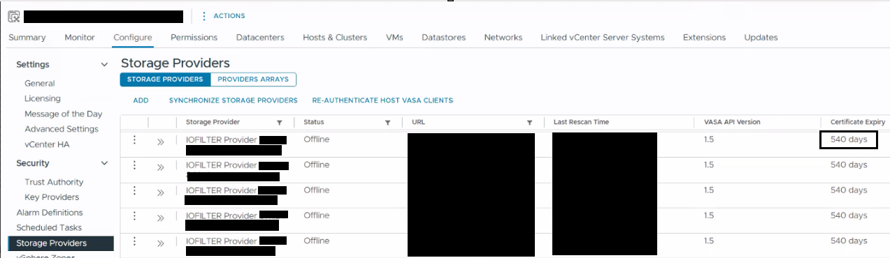

  1. Identify the Offline Provider
    1. Log in to the vSphere Client.
    2. Navigate to vCenter Server > Configure > Storage Providers.
    3. Look for providers with a status of Offline or Disconnected. Note the "Last Sync Time" (it may be significantly outdated)
