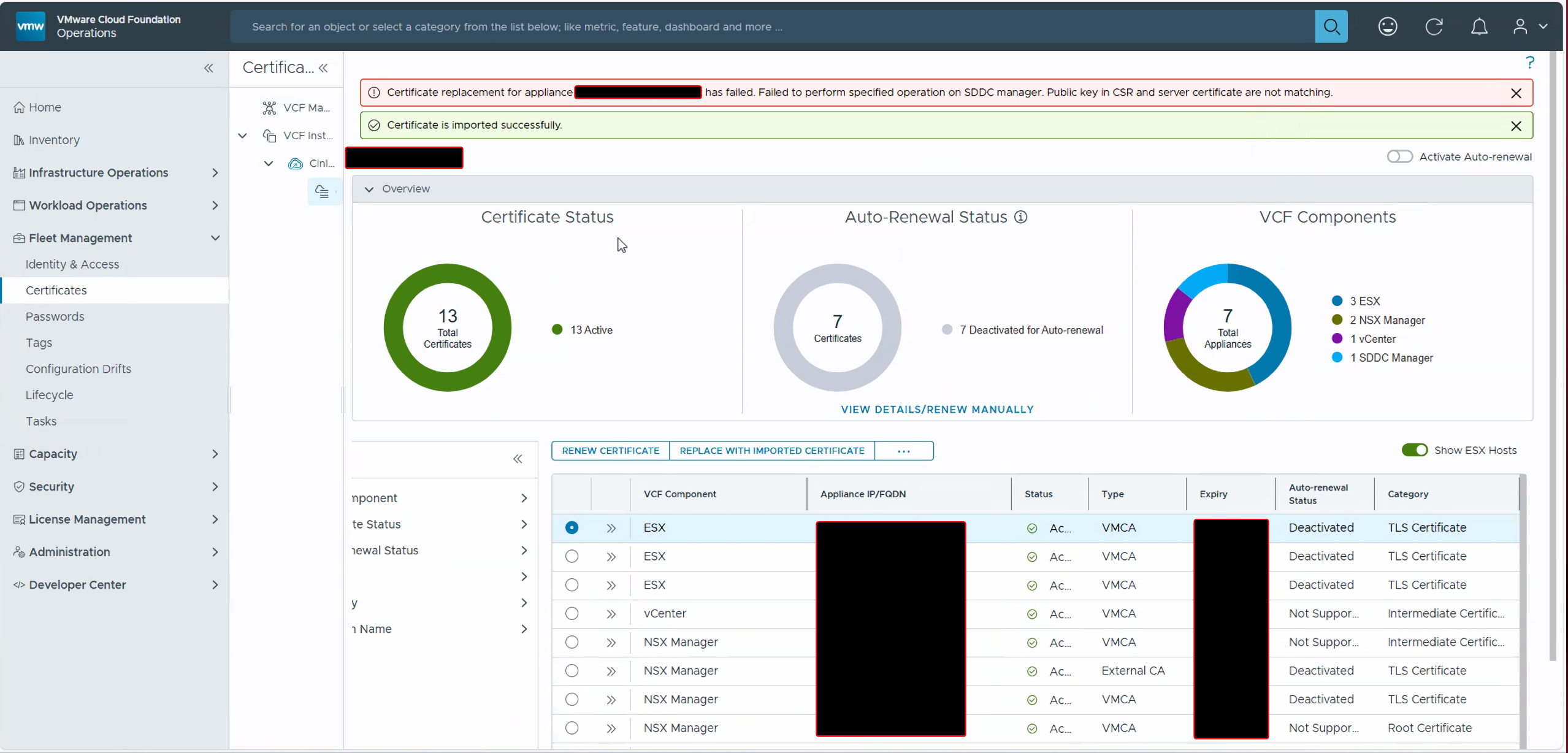

  • When attempting to replace the certificate for VMware Cloud Foundation (VCF) components using Fleet Manager, the operation fails with the following error:
Certificate replacement for appliance <FQDN> has failed. Failed to perform specified operation on <COMPONENT_NAME>. Public key in CSR and server certificate are not matching.

This issue occurs when there is a mismatch between the CSR generated and the certificate being applied to a specific component.
As observed in the logs, the system might retrieve a CSR generated specifically for one component (Eg: ESXi)  but the certificate replacement is being pushed using CSR generated for a different component (Eg: SDDC). Because the public key embedded in the signed certificate does not match the public key in the CSR that the system is referencing for that component, the validation fails.
To resolve this issue, you must ensure a strict 1:1 relationship between the CSR generated and the certificate applied for every single component.
