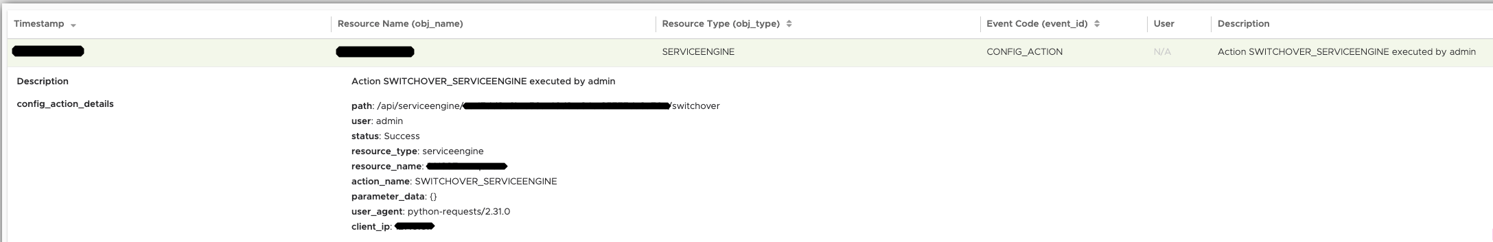

  1. Trigger Switchover: Log into the Controller CLI and execute the following command for the Active SE:
    switchover serviceengine <active_se_name>
    Note: Long standing connection with Service Engine will be dropped during the switchover of the service engine.
  2. Validate: Confirm that the standby SE (the one you just upgraded) has successfully taken over as the Primary for all Virtual Services.
  3. Switchover Event: Check the Service Engine Event to confirm if swhitchover command was executed successfully.

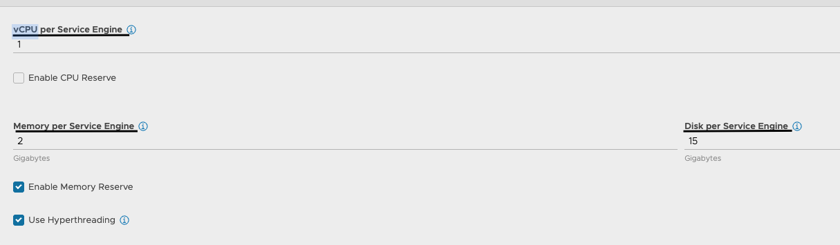

  • Navigate to Infrastructure > Cloud Resources -> Service Engine Group (Select correct cloud from drop down)
  • Edit the specific SE Group.
  • Update the CPU/DISK/Memory per SE field to match the new resources applied in vCenter.
Note: Failure to update the SE Group properties may result in resource mismatches if service engines are recreated.
