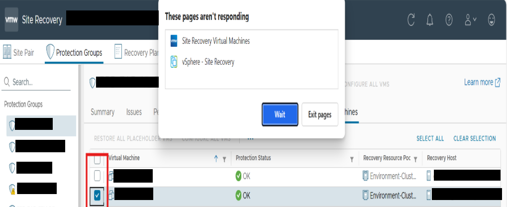

Whenever a virtual machine is selected from the protection group, the UI for for the SRM appliance crashes like below.

When checking the dr.log from the SRM appliance, we observe this below.
com.vmware.srm.client.topology.client.view.availability.ExtensionServersView$ServerByPairSetupException: Unable to get server with GUID 'XXXXXXXXX-XXXX-XXXX-XXXX-XXXXXXXXXXXX'. at com.vmware.srm.client.topology.impl.view.ServersViewImpl.lambda$getServerBy$1(ServersViewImpl.java:158) at com.vmware.dr.ui.tools.reactive.impl.PromiseImpl$ComposeCompletion.complete(PromiseImpl.java:202) at com.vmware.dr.ui.tools.reactive.impl.PromiseImpl$Result.complete(PromiseImpl.java:41) at com.vmware.dr.ui.tools.reactive.impl.PromiseImpl$Completion.lambda$setResult$0(PromiseImpl.java:63) at com.vmware.dr.ui.tools.utilities.ThreadContext.lambda$wrap$1(ThreadContext.java:55) at com.vmware.dr.ui.tools.utilities.ThreadContext.execute(ThreadContext.java:209) at com.vmware.dr.ui.tools.utilities.ThreadContext.execute(ThreadContext.java:185)
This is an indication of a permission issue, as the UI is crashing due to user permissions assigned to the non-administration role.
When the end user tries to edit virtual machines in protection group, the appliance UI will fail as it will not allow the user from editing existing protection groups.
This is a permission issue on the SRM appliance, the [email protected] account with full rights needs to be used, or an account with the same privileges as the administrator.
