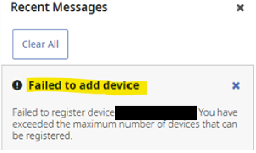

When attempting to add a new device (such as ISG, CAS, or Cloud SWG) to the Broadcom Management Center, the operation fails with the following error message:

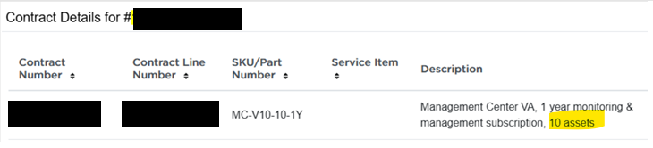

This issue occurs because the Management Center has reached the maximum device limit defined by the current license. Broadcom Management Center licenses are tiered based on the number of nodes or devices they are authorized to manage,. For example, the following allows to add up to 10 devices:
Once this threshold is met, the system will block any new devices to be added to Management Center.
To resolve this issue, you must either free up an existing "seat" or increase your licensed capacity. Follow one of the two methods below:
