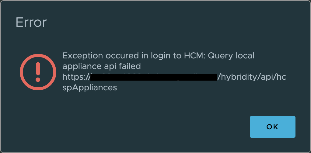

While performing 'Test Connection' On the config page for the HCX adapter Integration in Aria Ops UI, below error is seen,

java.lang.RuntimeException: Query local appliance api failed https://hcxappliancefqdn/hybridity/api/hcspAppliances
