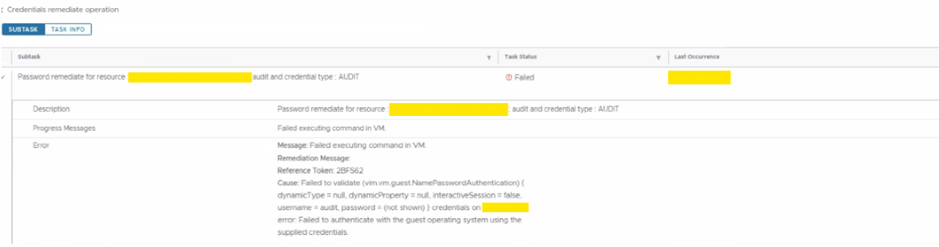

This /etc/passwd error is expected when the ROOT credentials are not in sync with SDDC Manager. The SDDC Manager needs to login as ROOT to download the /etc/passwd file to change the API/AUDIT passwords.
Which means the ROOT password needs to be remediated first.
However if the ROOT password is 123 on SDDC and the password was modified on NSX to 456 using passwd. The remediate will still fail for ROOT in SDDC Manager with the new (456) updated password - "failed to authenticate with the Guest OS"
This is because the root password has not fully changed in NSX despite using passwd command.

YYYY:MM:DDTHH:MM:SS.345+0000 ERROR [vcf_om,69956701ef9cf0460fa63147050b85c0,be2a] [c.v.v.p.u.c.AbstractPasswordChanger,om-exec-7] Failed to validate (vim.vm.guest.NamePasswordAuthentication) {
dynamicType = null,
dynamicProperty = null,
interactiveSession = false,
username = root,
password = (not shown)
} credentials on <hostname>, error: Failed to authenticate with the guest operating system using the supplied credentials.
com.vmware.vcf.passwordmanager.exception.PasswordUpdateException: Failed to validate (vim.vm.guest.NamePasswordAuthentication) {
dynamicType = null,
username = root,
