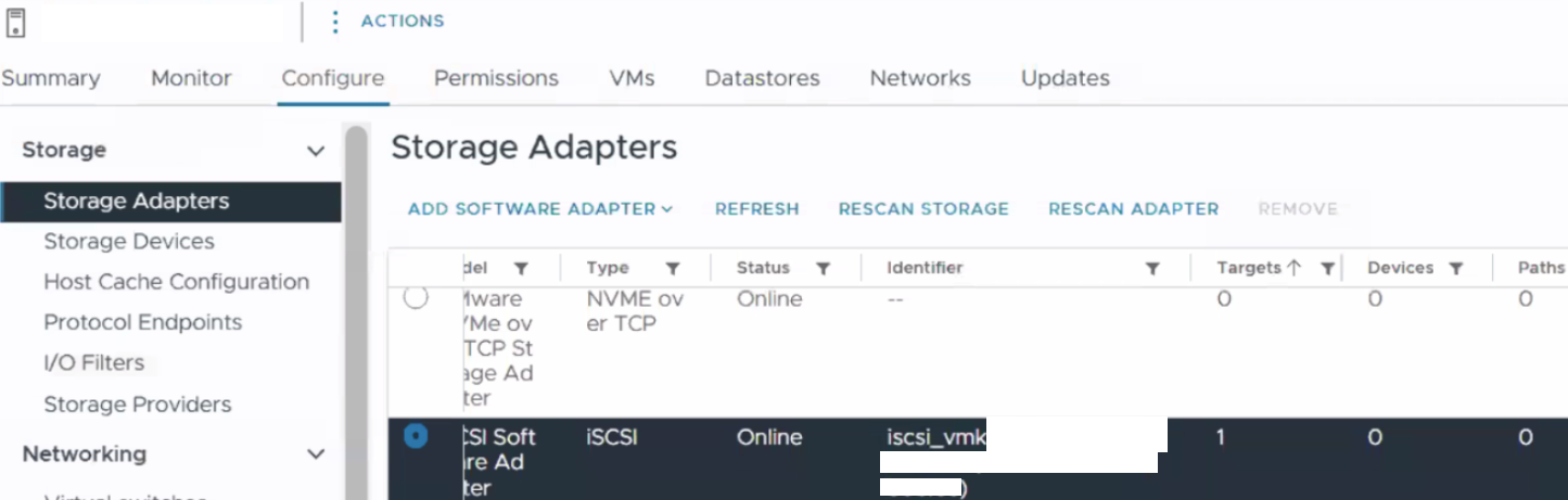

The recovery failure is caused by a lack of network path availability between the Recovery ESXi host and the target storage array. The Software iSCSI adapter is unable to establish a session over Port 3260, resulting in zero active paths and zero devices detected during the HBA
Validation:
Login to the target site and check the storage adapter being used for iSCSI:
Login to the target host and check the iSCSI connectivity to port 3260
Perform a vmkping test to the target along with the MTU size.
