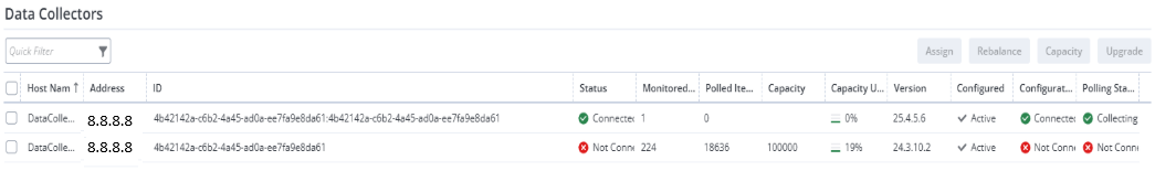

After upgrading NetOps we are seeing duplicated Data Collectors in NetOps Portal for the same IPAddress however they have different ID and Version.

During an upgrade from 25.4.3 and earlier releases using apache-karaf, to releases 25.4.4 and newer using springboot, an incorrect DCM_ID leads to an upgrade problem causing duplicate DC entries.
The collector-manager-id variable value in the $DC_HOME/apache-karaf/etc/com.ca.im.dm.core.collector.cfg file is incorrect.
It should be using a value that shows HOSTNAME:UUID
  • Some instances show a DCM_ID that only contains the UUID. No hostname precedes it.
  • Some instances show a DCM_ID that is just a seemingly random number. No hostname or UUID.
The correct format should be "<hostName>:<long_ID_String>".

  8. After a few minutes validate the DC shows as Green and fully connected in Portal UI.
    • Monitor Administration -> Monitored Items Management -> Data Collectors
  9. Confirm the DC shows the correct new DCM_ID in the ID column and that it's polled devices list looks correct.
