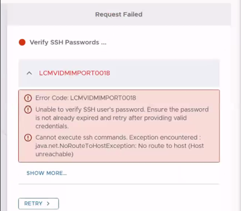

• The LCM user interface displays the following error: Error Code: LCMVIDMIMPORT0018
• When retrying the synchronization by manually inputting the new IP address, the task fails again, and the UI reverts the input to the old IP address.

INFO vrlcm[####] [pool-3-thread-##] [c.v.v.l.p.a.s.Task]  -- Injecting task failure event. Error Code : 'LCMVIDMIMPORT0018', Retry : 'true', Causing Properties : '{ CAUSE :: hostNameOrIP === vidmSshPassword ########  }'
java.lang.RuntimeException: Cannot execute ssh commands. Exception encountered : java.net.NoRouteToHostException: No route to host (Host unreachable)

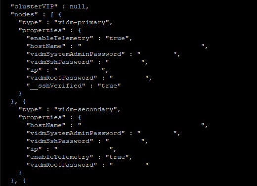

• Below the error in the vrlcm.log there will be two "type" listings. "vidm-secondary" and "vidm-primary". Both the old IP addresses and new IP addresses will be listed.

• During the IP address update procedure, the internal PostgreSQL database failed to overwrite the previous node network configurations. Instead, new rows were appended for the new IP addresses inside the ServiceInstance table, resulting in duplicated cluster records (e.g., 6 total entries for a 3-node cluster).
• When LCM performs an Inventory Sync, it queries the vIDM database to validate the cluster topology. Upon reading the ServiceInstance table, LCM retrieves the stale (old) IP addresses. It then attempts an SSH connection to an unreachable subnet, triggering the java.net.NoRouteToHostException. Subsequently, the LCM database caches this failure state and reverts the UI input to match the old IP it discovered.
