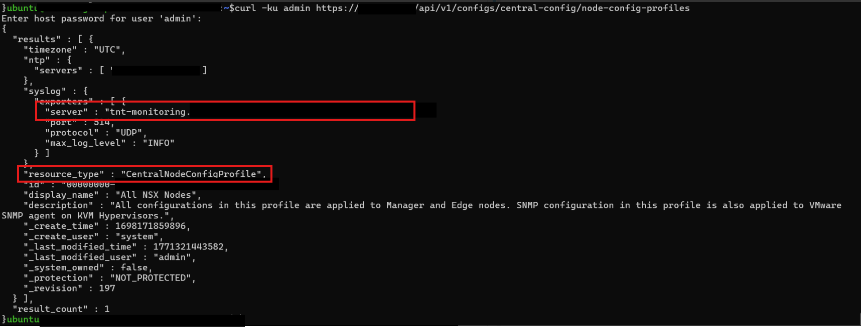

  • Syslog messages are not being forwarded from specific NSX Edge Nodes to the designated remote syslog server.
  • The Central Node Config profile is correctly configured and applied at the management level, but the settings do not persist to the Edge transport nodes.

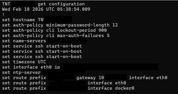

  • Verification via get configuration confirms the syslog server details are missing from the Edge VM's local running configuration.

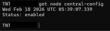

  • The command get node central-config confirms that the central configuration state is Enabled, yet the logging parameters are not inherited.

[TIMESTAMP] vmw-#######4 - [nsx@6876 comp="nsx-manager" subcomp="central_node_config_update" username="root" level="WARNING"]Failed to add syslog exporter {"port": 514, "exporter_name": "264aa005#######", "protocol": "TCP", "level": "ERR", "server": ####"}, response: {#012  "error_code": 36569,#012  "error_message": "Error modifying firewall rule due to invalid hostname.",#012  "module_name": "node-services"#012}, status: 400, err: 400 Client Error: Bad Request for url: http://####/api/v1/node/services/syslog/exporters
