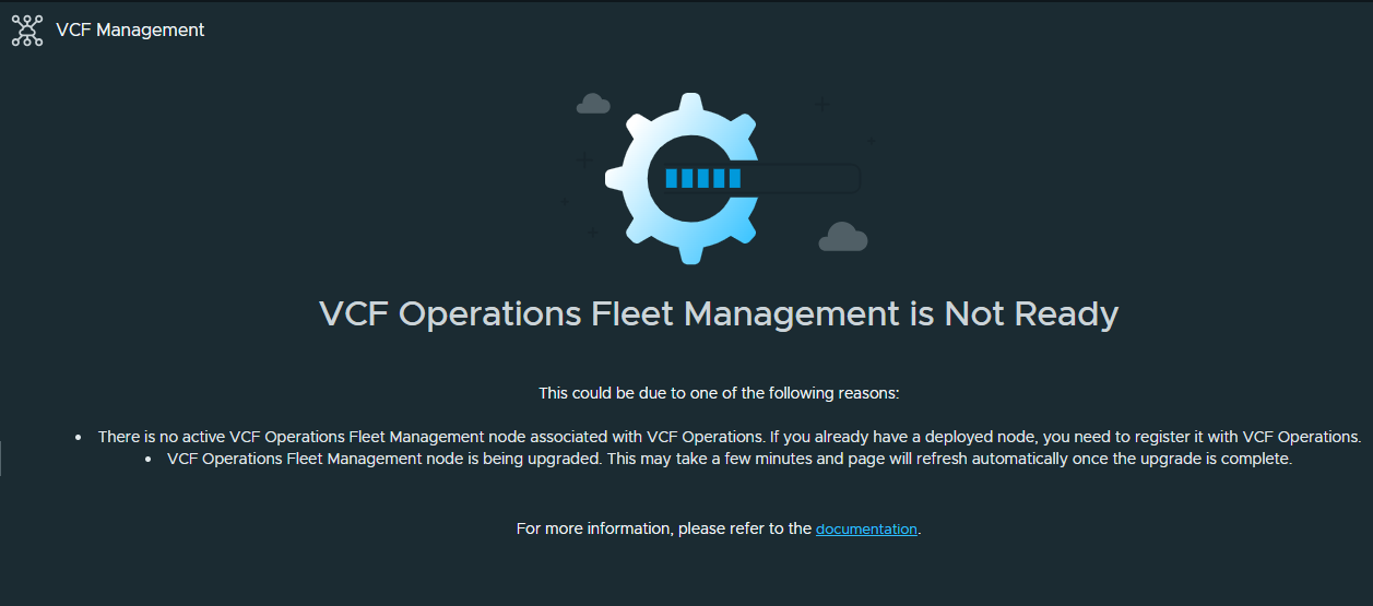

  • VMware Cloud Foundation Operations admin interface -> connect Fleet management shows this error: "Error connecting Fleet management node, try again".
  • The Option to delete Operations is greyed out when navigating to Fleet Management > Lifecycle > Components in the VCF Operations UI
