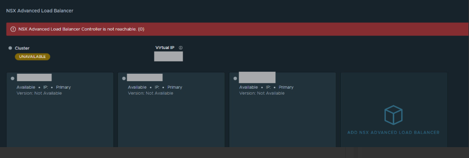

  • In NSX Manager, after removing an Avi Load Balancer, the controller nodes may still appear in the user interface or as stale entries in the system configuration.
  • Avi Load Balancer may display the following banner error:
    "! Some error1 has occurred."
  • Attempting to delete the AVI Load Balancers results in the error:
    "Error: Unable to fetch cloud configuration from Avi Load Balancer. Please try after sometime or use force delete option. (Error code: 94044)"
