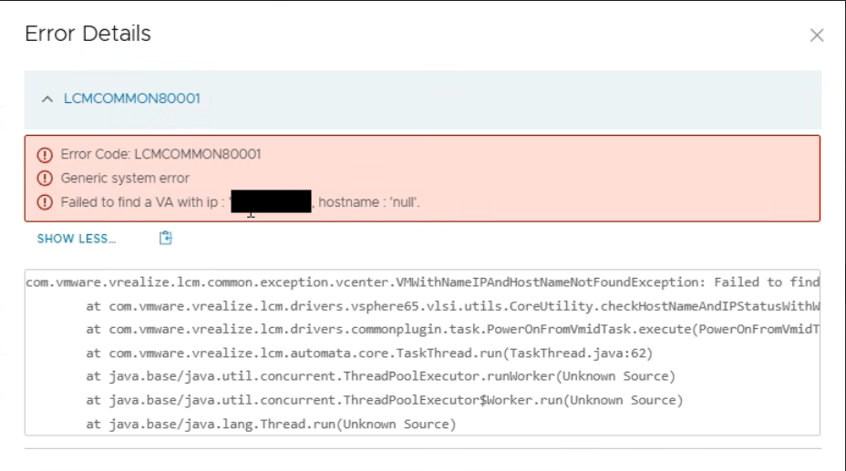

When attempting to replace the SSL certificate for VMware Aria Operations for Networks (AON) via VMware Aria Suite Lifecycle (ASL), the request fails.
The execution details in Aria Suite Lifecycle show the following exception: com.vmware.vrealize.lcm.common.exception.vcenter.VMWithNameIPAndHostNameNotFoundException: Failed to find a VA with ip : '<CATEGORY_REDACTED>', hostname : 'null'.
