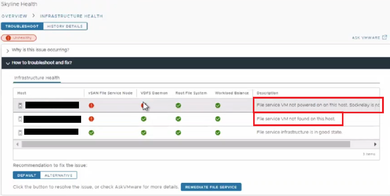

Symptoms:
  • vSAN Skyline health alert "Infrastructure health" reports that vSAN File Service VM (FSVM) is not found on host:
    Either of the below two errors may be seen:
    "File service VM not found on this host"
    "File service VM not powered on on this host. Sockrelay is not running"
  • Clicking on "Remediate File Service" does not redeploy the missing vSAN FSVMs on the hosts, although the remediation task may complete successfully.
