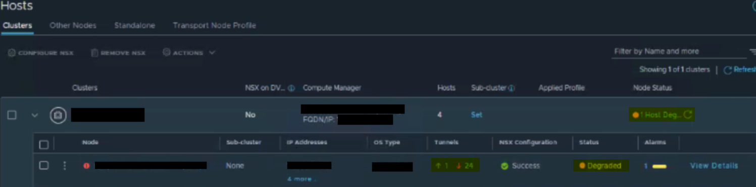

  • In the NSX UI, host transport node/s are in degraded status.
  • This is accompanied by multiple tunnel failures occurring between the Host Tunnel Endpoint (TEP) and the Edge TEP interfaces.
