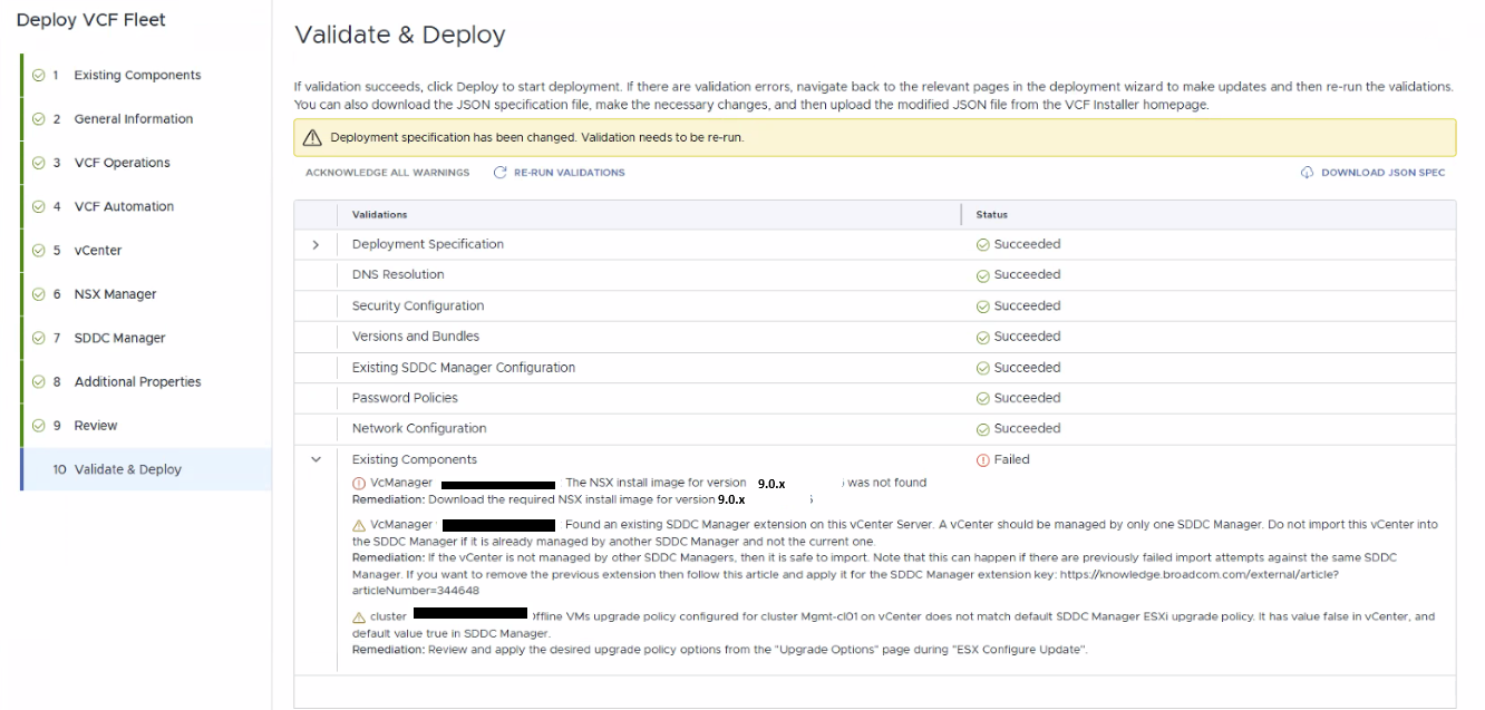

  • During the “Validate & Deploy” phase of a VMware Cloud Foundation (VCF) 9.x fleet deployment, validation may fail under the Existing Components section.
  • This usually happens when the VCF Installer is unable to find the required NSX Manager installation bundle for the vCenter Server being imported.

VCF Installer 9.x
  • The issue is caused by a mismatch or missing metadata in the deployment specification.
  • Even if the NSX bundle is present in the SDDC Manager, the VCF Installer may fail to associate the specific execution ID with the required workflow specs, particularly if previous failed attempts left stale configurations or if the workflow.json file does not contain the necessary greenfield/brownfield specs for the NSX deployment.
