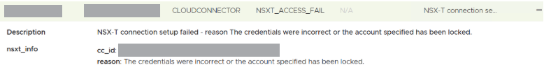

  • When you reset the admin password of an NSX Manager, the AVI Load Balancer may lose connectivity to the NSX Manager cluster with the following error:
  • This error is found in VMware Avi Load Balancer > Operation > Event:
    NSX-T connection setup failed - reason The credential were incorrect or the account specified has been locked.
