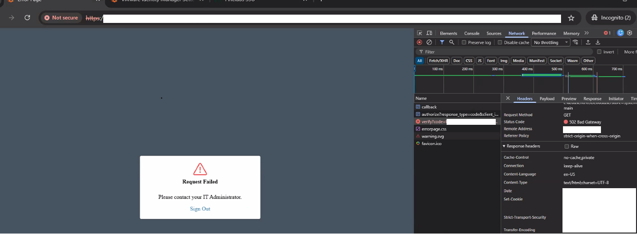

  • After entering credentials at the VMware Identity Manager (vIDM) login page, users receive a "Request Failed. Please contact your IT administrator" error message.
  • Browser Developer Tools (Network Tab) show a 502 Bad Gateway error.
