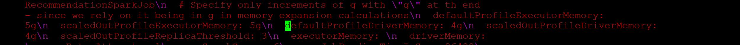

To do this do the following to change those values and restart recommendation server. Login to SSPI using sysadmin credentals and perform steps as below:
         k  - n nsxi-platform edit cm recommendation-app
         Change defaultProfileDriverMemory and scaleOutProfileDriverMemory from 4g to 6g
      snippet for reference:
k  -n nsxi-platform  | grep recommendation; Find the recommendation api server pod
sample output for reference:
recommendation-744c6df49f-mvbs8                                   2/2     Running     0             28h
recommendation-clean-up-cronjob-29514255-9x2m7                    0/1     Completed   0             51s
recommendation-continuous-monitoring-cronjob-29514255-n7rqg       0/1     Completed   0             51s
recommendation-monitor-failed-spark-job-cronjob-29514240-b8b8z    0/1     Completed   0             15m
k delete pod recommendation-744c6df49f-mvbs8 ( pod name taken for the reference from above sample output)
A new recommnedation api server will start and next time you start recommendation, the job will start with more resources.
