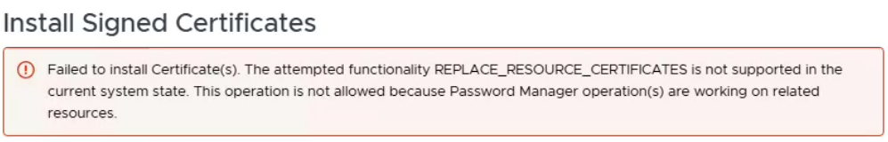

  • When attempting to install or replace SSL certificates for components (vCenter, NSX, etc.) via the SDDC Manager UI, the operation fails.
  • The UI displays a generic error as follows:
  • Certificate replacement tasks appear stuck or fail immediately.
  • But the underlying system reports that the state is invalid for the requested operation.

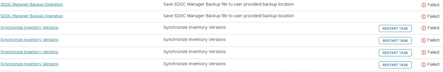

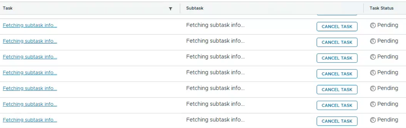

  • From the SDDC UI, there are too many Stale Tasks are in the state of Pending/Failed/Running as follows:
  • Under SDDC Manager's, /var/log/vmware/vcf/operationsmanager/operationsmanager.log, below entries are available, indicating "leftover" or "stale" tasks:
    YYYY-MM-DDTHH:MM:SS INFO  [vcf_om,##########,####] [c.v.v.t.services.TaskPublisher,om-scheduler-1] Found leftover task {"_type":"Task","_value":"task-######","_serverGuid":"########-####-####-####-########"} and marked it as failed!
