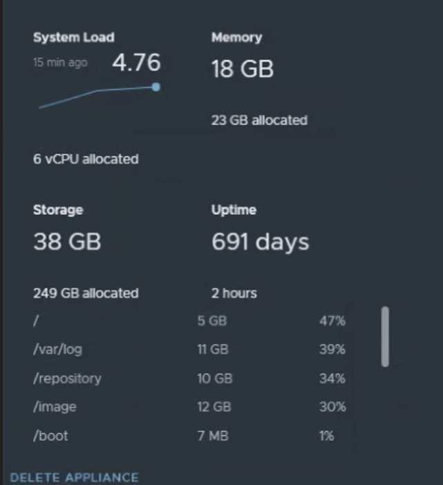

After successfully applying all certificate fixes, it is observed that all Manager nodes (LMs and GMs) have unusually high uptimes.

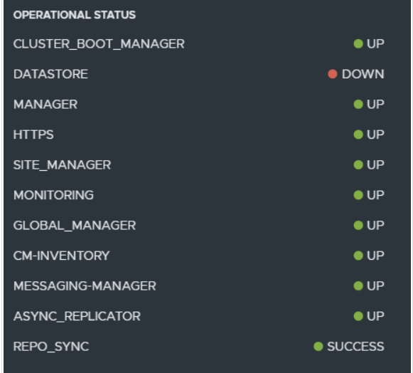

When proceeding with a controlled reboot of the first Global Manager in the cluster, all services return to a running state except for the DATASTORE service. Despite waiting an extended period of time, the DATASTORE service does not start, and the Manager cluster remains in a DEGRADED state.

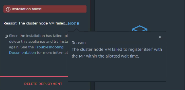

An attempt to delete and redeploy the affected third Manager node through the NSX UI fails during the redeployment process at approximately 55% completion after around 40 minutes, returning the error below:
A manual redeployment using the OVA template also fails. When deploying the Manager manually and executing the join-cluster command via CLI, the process fails with the same error, preventing the node from successfully joining the cluster.
When running get cluster status from admin of one of the healthy GM's you may see the Status of UNKNOWN for the failed deployed manager on the DATASTORE service but not present in any of the other services.

When peer certificates are not properly propagated, nodes may not trust each other during inter-node communication. This results in TLS handshake failures, commonly observed as PKIX path building or certificate validation errors. Consequently, the join operation may fail, or the node may remain stuck in a JOINING or Install Failed state, leading to a DEGRADED cluster condition.
