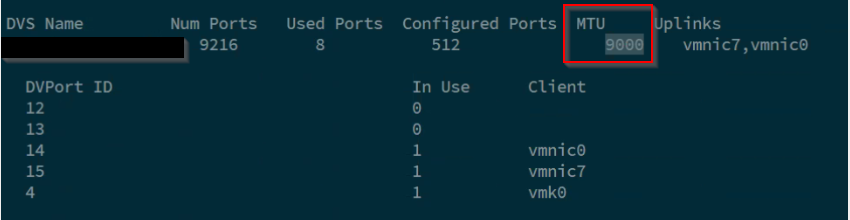

Specifically, the below command showing the switches on the host shows the vDS in question with an incorrect MTU:
esxcfg-vswitch -l
