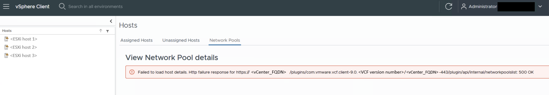

  • When attempting to access Network Pools from within a workload domain vCenter UI, the operation fails with a 500 error. Users typically observe the following error message in the browser
    Failed to load host details. Http failure response for https://vcenter.domain.local/plugins/com.vmware.vcf.client-9.x/sddcmanager.domain.local-443/plugin/api/internal/networkpoolslist: 500 OK
  • This issue occurs specifically when navigating to the VMware Cloud Foundation (VCF) plugin components while logged into a vCenter Server associated with a workload domain.
