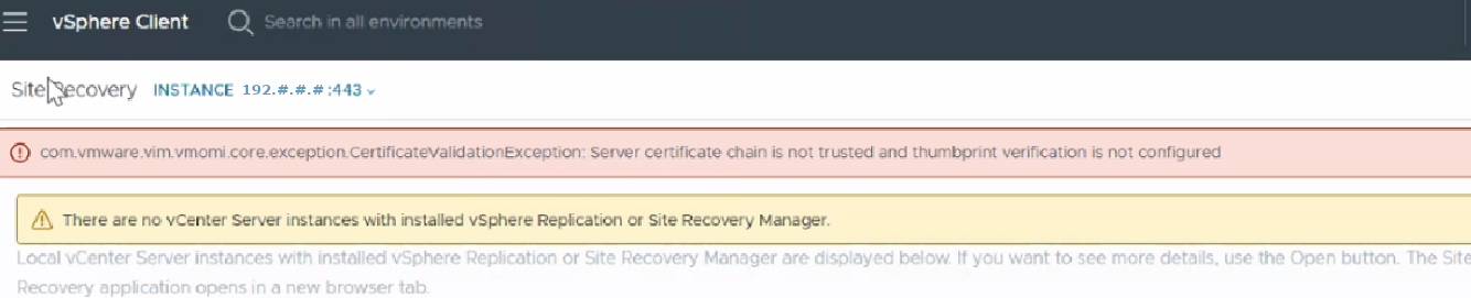

  • After replacing an expired vCenter certificate (Machine SSL cert) SRM and VRMS is not accessible from vCenter.
  • The Site Recovery UI is inaccessible from the production vCenter Server with error message "com.vmware.vim.vmomi.core.exception.CertificateValidationException: Server certificate chain is not trusted and thumbprint verification is not configured"

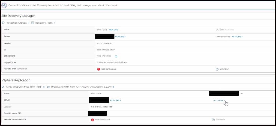

  • While the DR Site Recovery UI remains accessible, both Site Recovery Manager and vSphere Replication are displaying a "Disconnected" status.
