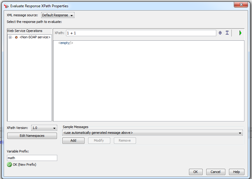

Setup: In order to do XPath math, drag a Response XPath over into our Gateway's policy workspace. In the 'XPath:' window enter the mathematical function to be executed. This field supports a very flexible array of functions as demonstrated in the attached policies. To access the result of the equation, use the *.results context variable that is created by this assertion. The prefix to *.results will depend upon what is used as the variable prefix in the lower left hand corner of the Response XPath Assertion. For example, in the use case pictured below, the result would be '2.0' and accessed via the 'math.results' context variable:

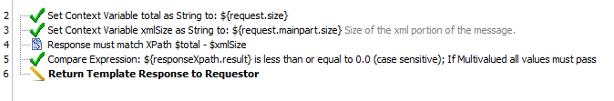

To get a bit more complex, use context variables in the XPath field. The variables used should be saved as a string, and invoked in the 'XPath:' field in the format $variableName. Note the lack of curly brackets around the variable [ {} ]. The policy below shows how this could be utilized to ensure there is an attachment on a message by taking the total request size, subtracting the size of the main body of the message, and seeing if there is a remainder.
